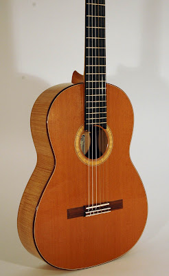

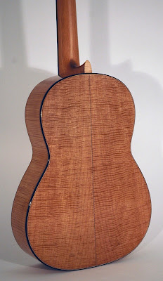

Postby Jeremy Clark » Thu Jan 27, 2011 3:59 am
I have built quite a few actually and it beats me why it's not more common --one of my most favorite combinations. Something about the low damping top paired with the high damping back.
Image Image
