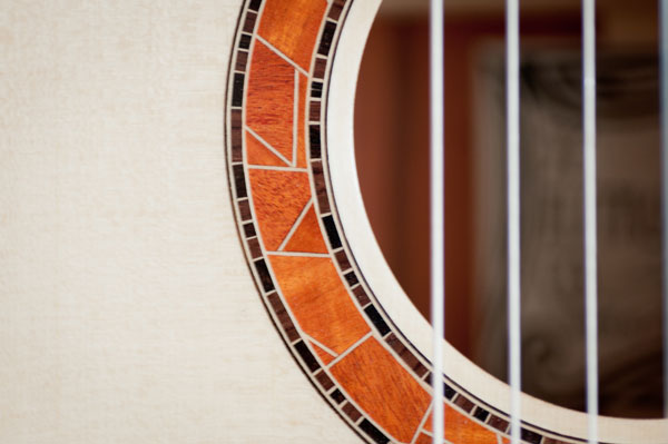

Postby Jeremy Clark » Tue Mar 13, 2012 10:08 pm
I realize that most guitar players are not as familiar with pernambuco (as a wood not a composer) as their bowed string instrument cousins might be but in my mind there are very few woods as perfectly suited to a concert instrument. A year or two ago I had the opportunity to acquire a reasonable sized board of perfectly vertical grain Brazilian pernambuco and this guitar is one from that board.
Just a couple of photos (but there will likely be some more on my site in a week or so.)

Re: A unique piece leaving my shop... or a Pernambuco guitar
Postby guitargeorge » Tue Mar 13, 2012 10:48 pm
what a beautiful instrument, especially the modern lookign rosette, which remind me of mediterranean tiles.
Postby Jeremy Clark » Wed Mar 14, 2012 2:50 am
Aaron Green wrote:...are made from African Blackwood aka Dalbergia Melanoxylon ....
That's what I thought. Though really I don't see any reason not to. I bet it could build great oboes --though what to do with the oboists is an entirely other debate.
Having spent most of my life also playing violin I knew pernambuco (like Aaron said) as the premier wood for bows. Most of the attributes that make it a great bow wood also, I think, make it a phenomenal wood for guitars.
With the rosette I was kind of into the nonspecific as opposition to the disciplined. I used two different origins of pernambuco to provide a sort of contrast and bordered it with Afican Blackwood (go clarinets) and a quite dark cocobolo --the body being bound in cocobolo from the same board. More than anything it's just my current take on a mosaic.
The camera can't quite capture the change in chatoyance between pieces. I would absolutely do it again -- in fact I glued a couple in a similar style earlier today. Sure it's not a carbon copy of the traditional but It's just me having fun in the shop.
N.B. I want to mention that all of these photos were taken my friend Noemie (http://www.noemieletu.com) with the guitar on a bench in our shop and lit by a steady sunbeam that we enjoy for most of the day.
Postby AdamX » Wed Mar 14, 2012 4:06 am
Guitar looks great. I love the mosaic rosette design and purfling. It's simple but has a little bit of an art deco vibe.
Postby AdamX » Wed Mar 14, 2012 5:48 pm
What kind of finish do you use?
That's a gorgeous guitar.
Postby Jeremy Clark » Thu Mar 15, 2012 5:05 am
AdamX wrote:What kind of finish do you use?
This guitar (like most of my work) is french polished. It's one of my favorite parts of the entire process and I really love being able to hang out in the shop, listening to great music and drinking delicious coffee while finishing my instruments. Who wants to put on a "fancy suit" and breathe through a mask in pursuit of making something shiny that's just going to end up crazing anyway? The mind boggles...
and in terms of the "dropping building materials"... there are plenty of great archetiers in the world making phenomenal bows but why should they have all the fun? I think if I was a pernambuco board I would feel okay about being a guitar rather than a bow...
