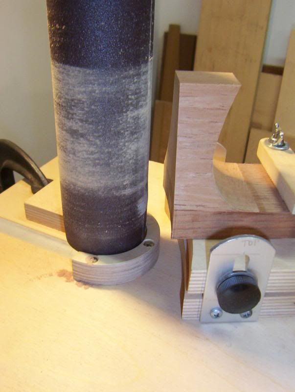

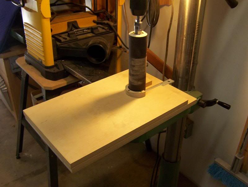

There are four components to the fixture for shaping the neck/heel end to match the curvature of the body. (1) This plywood has a bearing set in an aluminum bar let into it.
(2) The sanding drum has a pin that seats in the bearing, and the other end chucks in the drill press.
(3) The second piece of plywood has the 'curb' that the sled will ride against.
(4) This is the sled. HInges at one end, slotted aluminum and turn screws at the other end allow the angle to be adjusted.
The neck in the sled ready to be sanded.

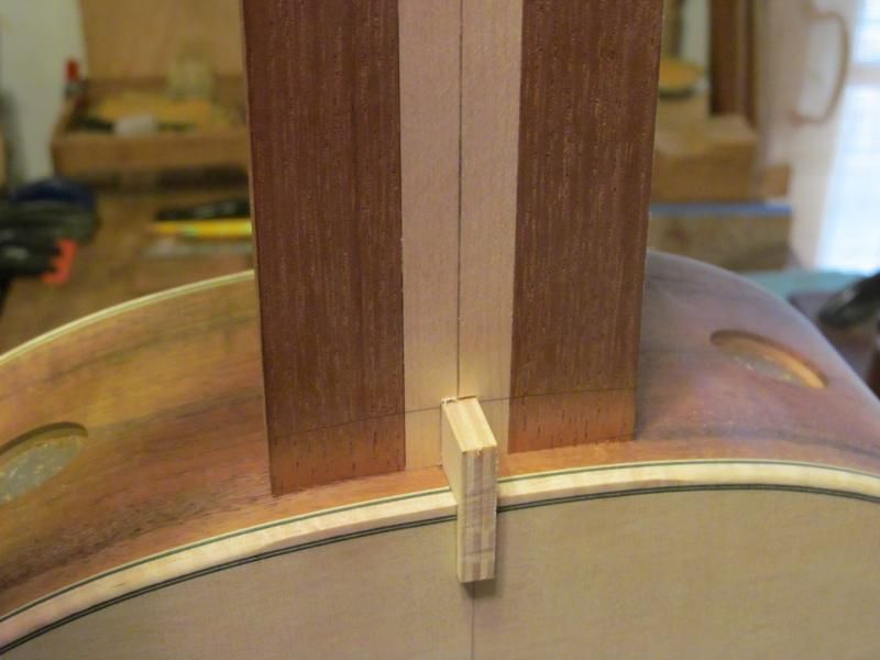

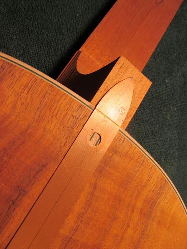

Neck/heel and body have been mortised for the Baltic birch tenon.
Checking the fit.
Laying out the heel end shape.
Pre-carving the heel end of the neck.
More carving. I could not live without my Japanese paring chisel.
Final check of the fit.

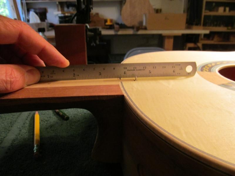

The neck ready for the fingerboard. Two pins locate the board, one at the first fret and another at the 13th, just to the right of the spline.

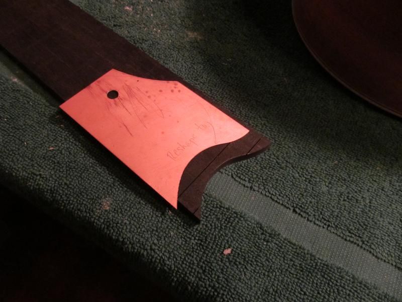

Marking the board where it meets the sound hole edge. Going to do a 20th fret.
Template and finished end of the board. I'll fill the bass side of the 20th fret later.
Showing the neck and upper bout in plane. Neck angle is forward.

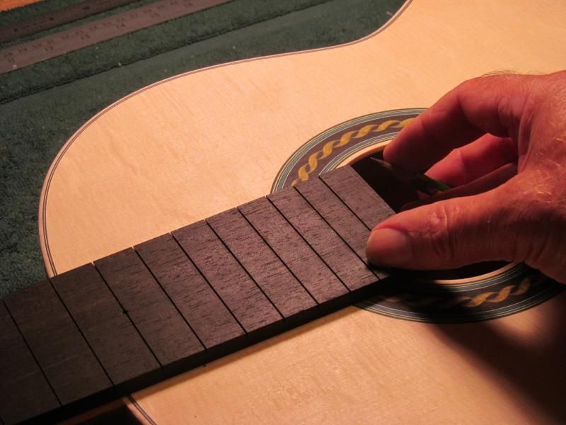

A little hard to see here, but the fingerboard is a straight line right to the sound hole.
Last check on the fingerboard alignment relative to the center line.

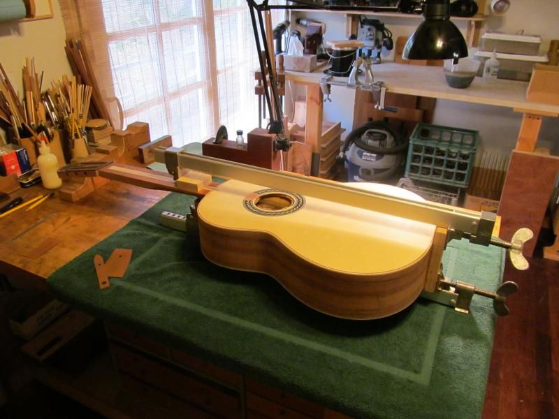

The clamping set up. I love wooden screw clamps.
Clamping above the 12th fret. The middle larger C clamp has an angled caul that fits to the foot.
