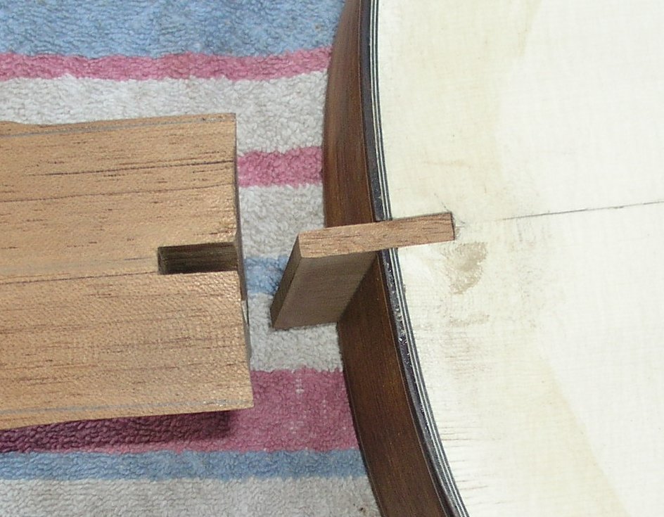

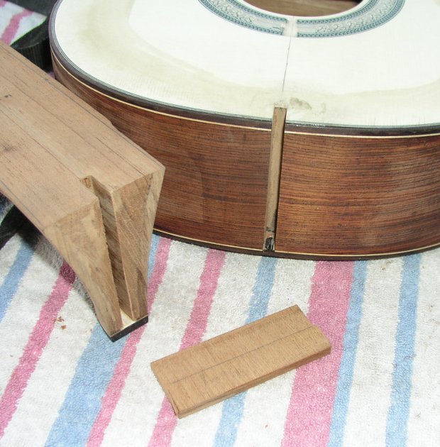

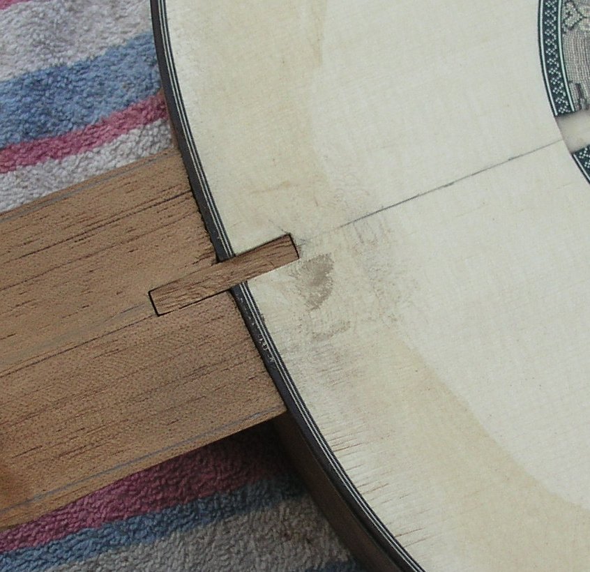

I've used many types of neck/body joints. Spanish method, Gilbert tapered mortise and tenon (Dove tail without the dovetail), and my favorite the double mortise spline joint. Makes no difference in the sound. Anyone who says the Spanish joint is superior for sound is full of hot air. Empirical data proves otherwise.
The double mortise and spline joint is just a 1/4 mortise in the body and in the neck heel. The neck angle is tested and fitted and then a 1/4" spline glued in to attach both parts.

I like the spline joint too. Funny story, I made a really nice guitar for one dude. I documented the spline joint process and jig. Showef the photos to others on a guitar forum. The guy got all pissy and said that that kind of joint was cheating and only people who make mistakes on the traditional Spanish way my
I just shook my head. Some people are just crazy. I do both
Patience at the bending iron pays in rounded dividends!
