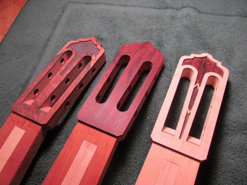

Necks in various stages of completion. The far right one is for an all POC guitar which I hope to finish before 2020.
