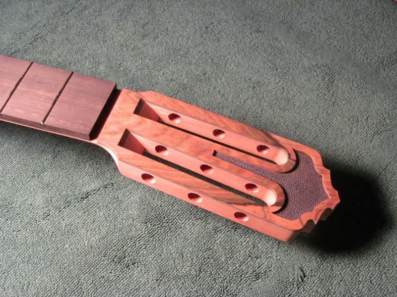

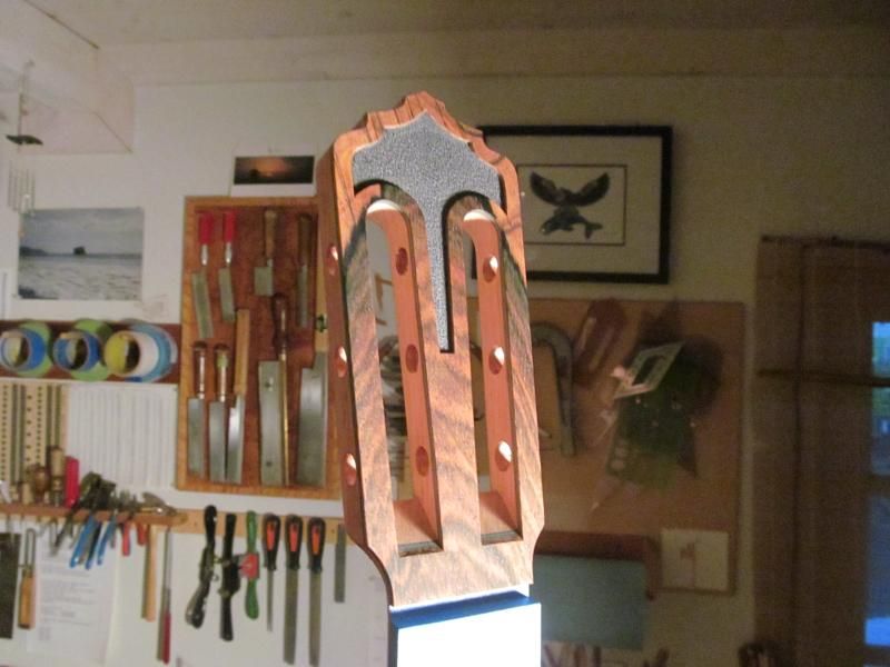

Classicalmark wrote:That is a very beautiful guitar. I particularly like the rosette and head stock. The headstock ornamentation reminds me of Simplicio guitars that I have seen (never played though). Thanks for sharing.
Thanks for the kind comment, I appreciate you noticing those two things.

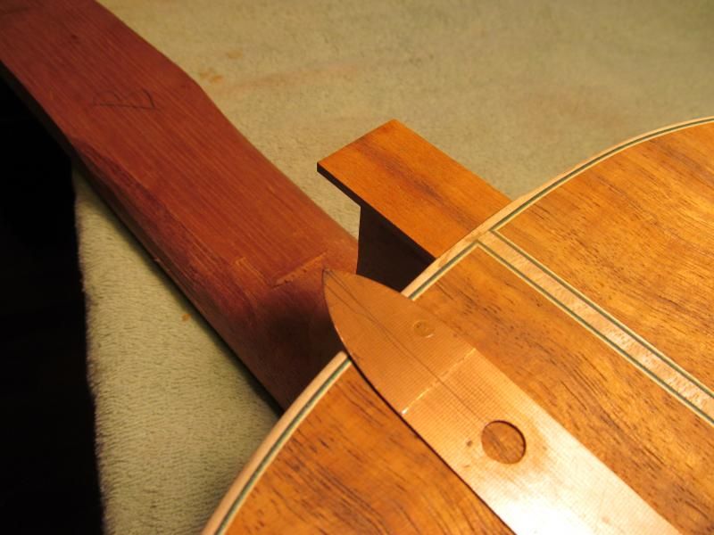

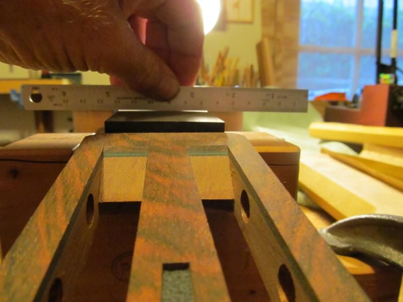

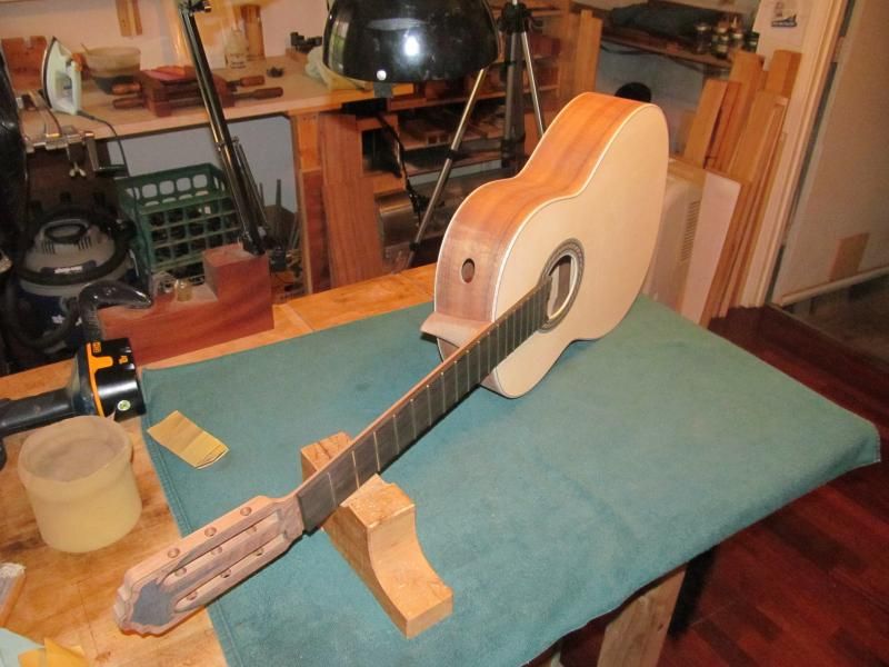

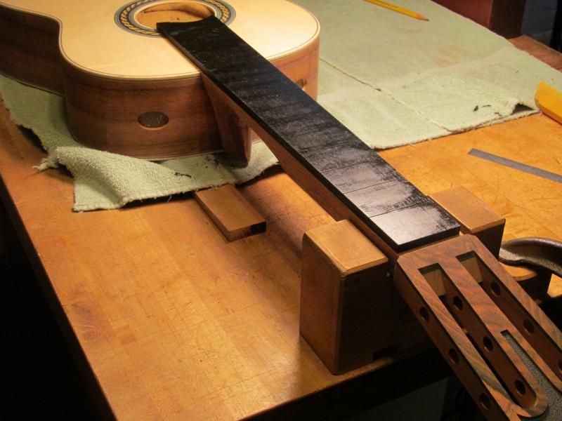

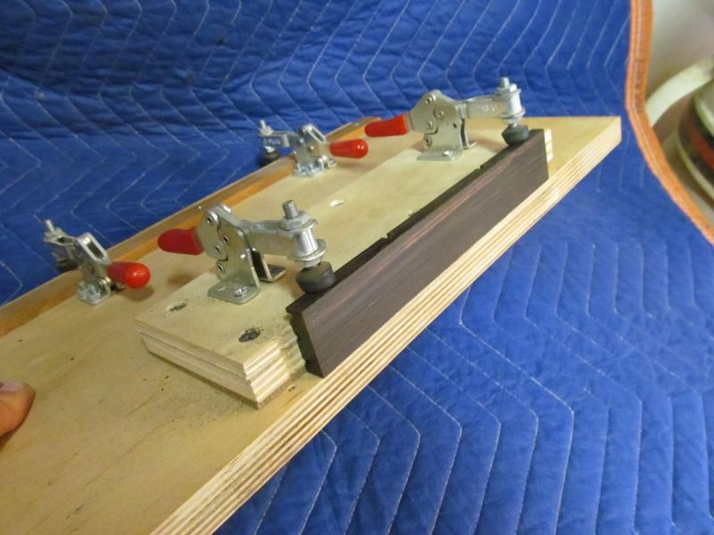

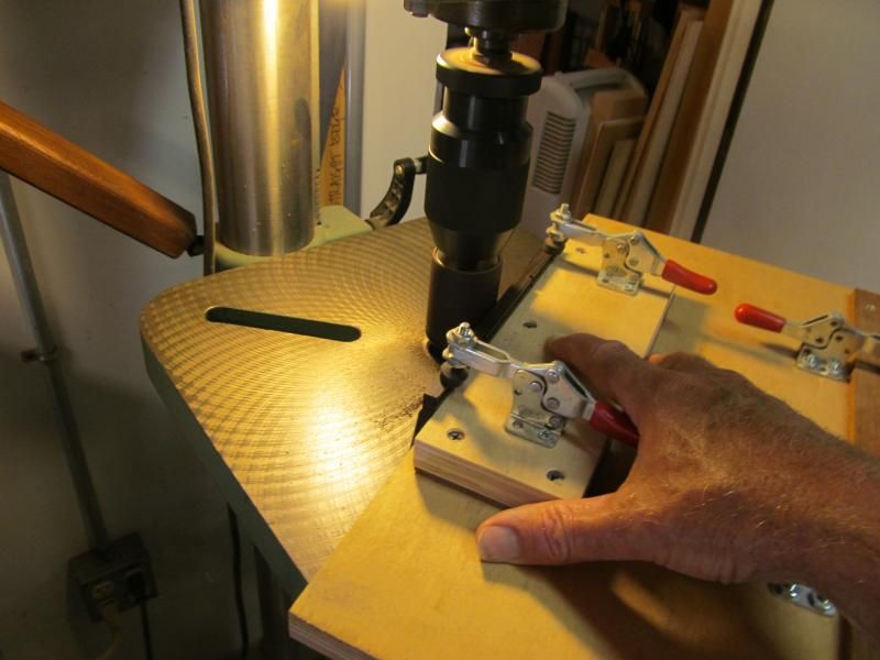

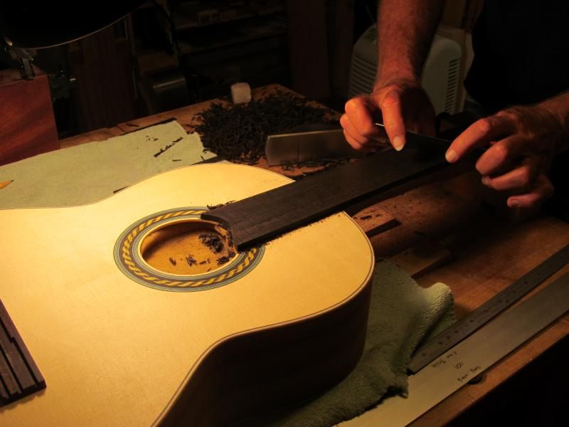

In order to shape the top of the fingerboard I like to have the actual bridge set in place, so I need the underside to match the curve of the dome of the top.
The jig works with the drill press and a Robo sander.

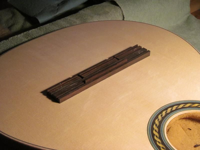

Bridge sitting where it will live, with a dummy saddle. I use an action stick to mimic the string band, dictating how to plane the board.

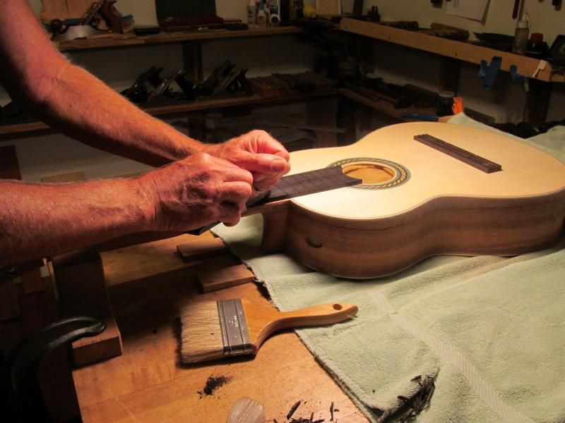

Planing the fingerboard. Do not hit the top while planing!
Scraper after the hand plane. You can see how much wood I removed in the pile of ebony shavings.
Superglue on the fingerboard. Ventilation required.
Crown of the board. Looks like more than it is.

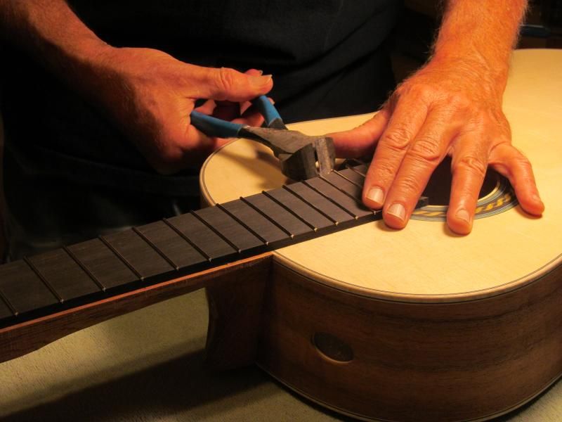

Cutting fret ends. Warning, another opportunity to damage the top here.

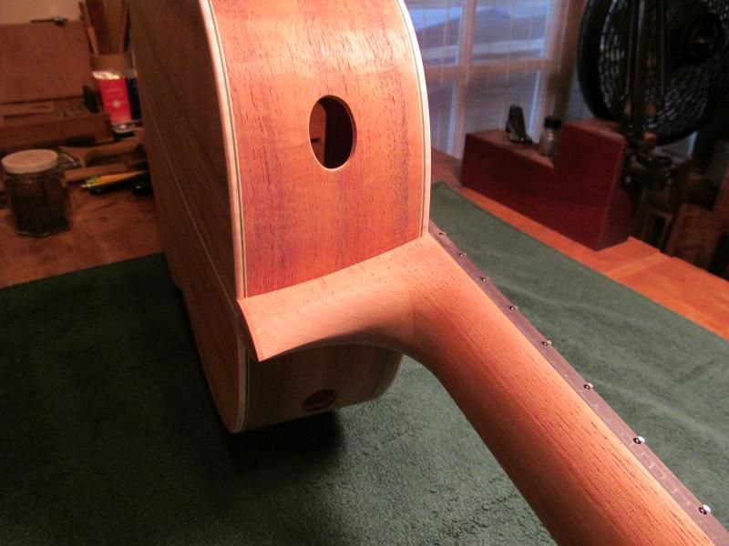

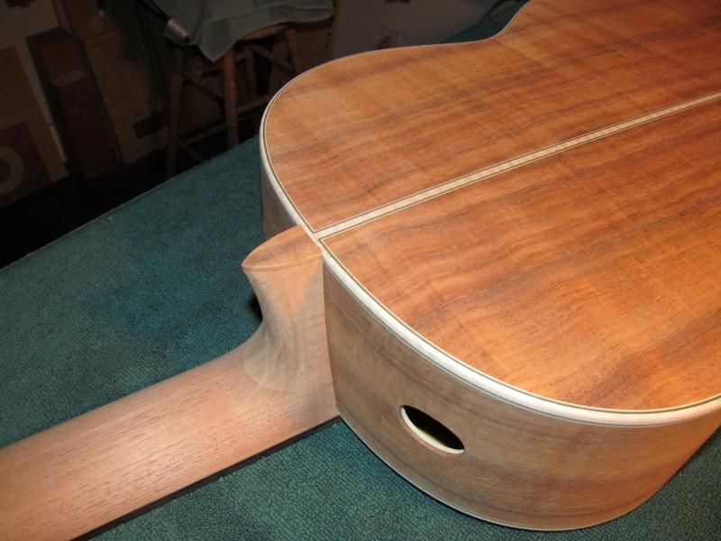

Marking the heel cap before starting to carve the neck.

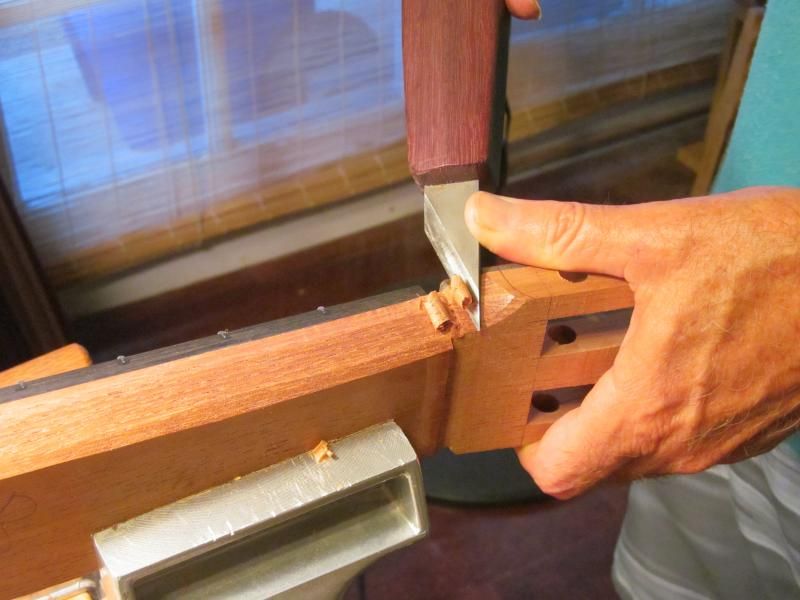

Nothing like a good knife for carving areas like this.

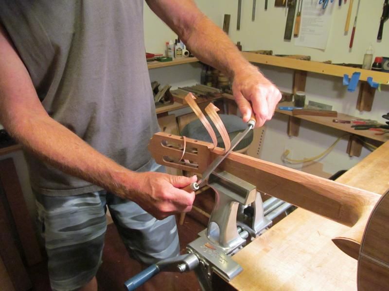

I love my drawknife.

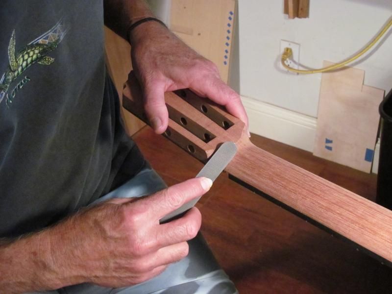

A half-round rasp with safety edges and a rounded end to blend the transition from neck to head.
Filling the fret slots with blackened epoxy.

Thanks for sharing this work sequence. What is the application of cyanoacrylate to the ebony fingerboard for?

iim7V7IM7 wrote:Thanks for sharing this work sequence. What is the application of cyanoacrylate to the ebony fingerboard for?
You're welcome.
Regarding the cyano, the thinking is that flooding the board with it will help stabilize the ebony, which is notorious for continuing to dry and shrink, even after years of seasoning in a shop.
p

Do you find using a drawknife more controllable than a spokeshave or is it just faster?

Interesting, I had never seen an ebony fingerboard flooded in that manner for that purpose.
You're welcome.

Charles Simons wrote:Do you find using a drawknife more controllable than a spokeshave or is it just faster?
Looking very awesome!
The advantage of a good, sharp drawknife is that it is fast. There is a minimum of 3 mm of wood in thickness to remove, so I can get rid of that quickly, then change to the spokeshave, a knife, a scraper, and sandpaper. If you start wtih a thinner neck blank, the heel to neck joint will creep out on the flat of the neck, and become almost feathered. Plus I like the look of the joint landing up a bit on the curved surface.

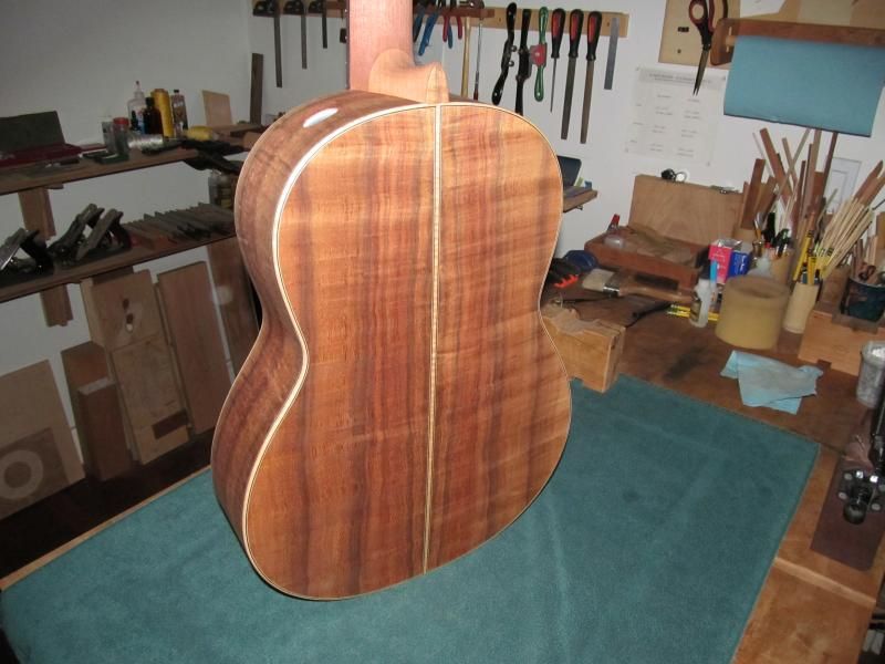

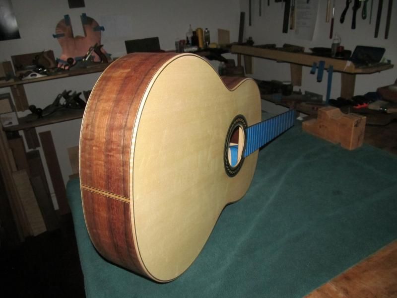

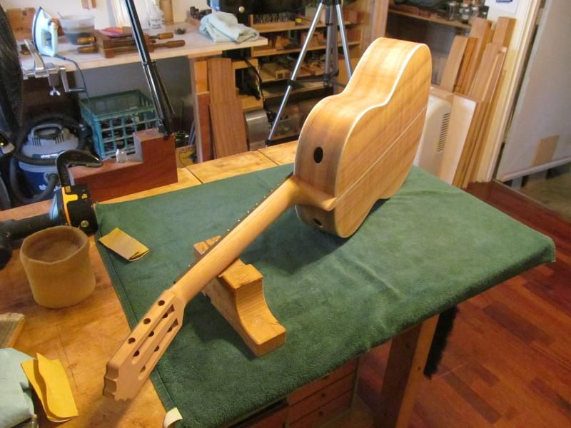

In the white:
Freshly egged and ready for polish:

One question I have: Is the inclined angle of the peghead quite shallow (relative to the fretboard) or perhaps
it's the camera positions ? Most tasteful carving on the face btw.
