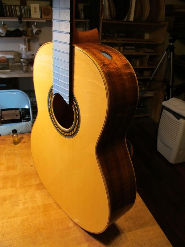

iim7V7IM7 wrote:Beautiful Peter...
Once you get some french polish on it, the flamed curl of the koa and the hazelfichte in the engelmann will begin to visually blossom.
Kudos
Thank you. I've been anxious to get some polish on it for exactly that reason. Thanks for your comments.

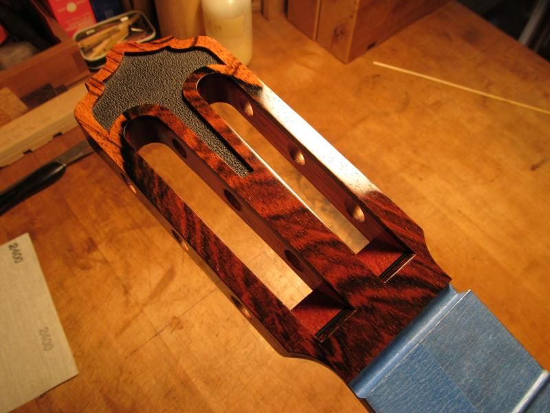

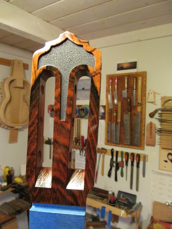

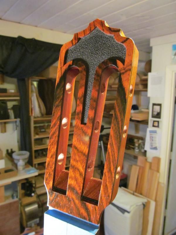

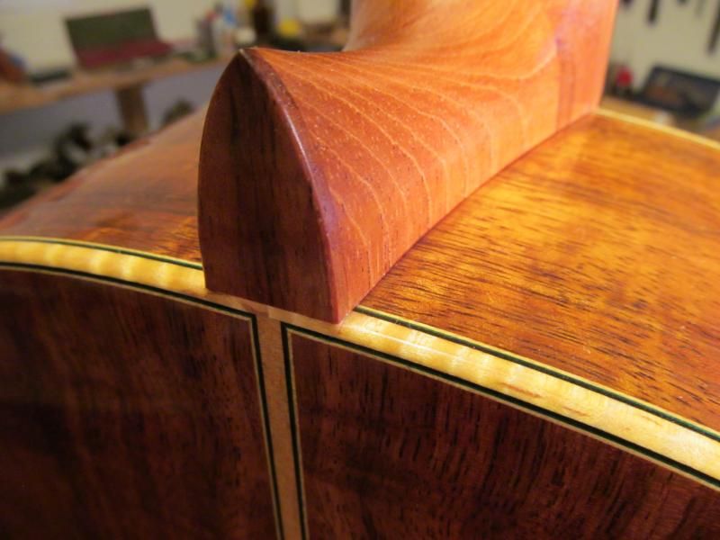

martinardo wrote:Great thread and photos, Peter. Thanks for taking the time to document some of the steps
in your marvellous work.

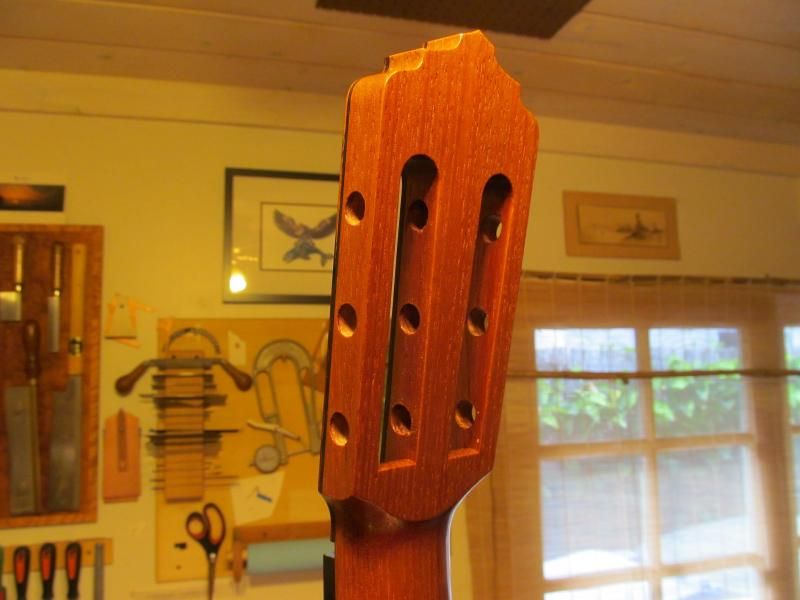

One question I have: Is the inclined angle of the peghead quite shallow (relative to the fretboard) or perhaps
it's the camera positions ? Most tasteful carving on the face btw.
Thanks for the kind words. The head angle is 12 degrees. I think the picture makes it look less than it is, but I do think 12 degrees is a bit less than most use. I think the average might be closer to 14-15 degrees, but I'm not sure about that.

Post by Waddy Thomson » Fri Aug 01, 2014 11:25 pm

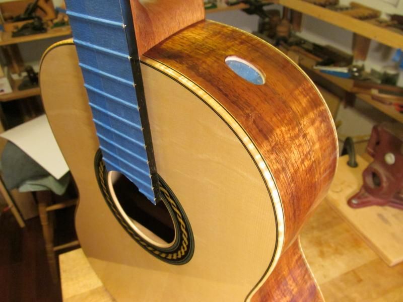

I like 12 degrees too, and use it myself. Lots of builders use the "normal" 15 degrees, particularly for a scarf.
Your work is beautiful, Peter! Is the neck just glued on with the clamping system and spline? No bolts.
Waddy

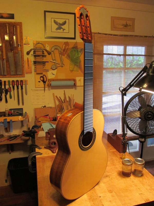

Peter Oberg
Posts: 808
Joined: Fri Jun 30, 2006 10:44 pm
Location: San Diego, California
Re: New Koa and Spruce
Post by Peter Oberg » Sat Aug 02, 2014 3:03 am
Waddy Thomson wrote:I like 12 degrees too, and use it myself. Lots of builders use the "normal" 15 degrees, particularly for a scarf.
Thanks for taking the time to comment Waddy, really appreciate that.
That's correct, no bolts. I spend some time making sure the neck/heel end mates perfectly to the body, then size the joint before gluing. Between that, the spline, and
the fingerboard adding to the structure there's no doubt in my mind it's a solid setup.

Brian Brogan
Post by Brian Brogan » Sun Aug 03, 2014 3:57 pm
Wow Peter,
What an awesome looking guitar. I'm sure it sounds fantastic. I really enjoyed following the process and love the detailed pictures. I've always liked recessed and stippled (?) headstocks and hope to try that on my next guitar. Thanks for taking the time to detail this build. :D

Really neat. I love your work Peter ! I think I will adopt your neck joint for my next build. Do you glue it with epoxy, titebond, hide glue ? I know how to size with hide glue but not with the other types (titebond doesn't glue well on itself).

Brian Brogan wrote:Wow Peter,
Thanks Brian. Just go for it on the headstock of your next guitar-find a design for the recessed area that you like and have at it. Bit of a challenge that, but good for refining the hand tool skills.

Johan Espina wrote:Really neat. I love your work Peter ! I think I will adopt your neck joint for my next build. Do you glue it with epoxy, titebond, hide glue ? I know how to size with hide glue but not with the other types (titebond doesn't glue well on itself).
Thanks Johan. I size the end grain with diluted Titebond, let it dry well, lightly sand and then glue on the neck. It's not really gluing to itself-most of the diluted glue is absorbed into and seals the end grain. I think it's probably not even necessary, and I have to admit I think I forget to do it sometimes!

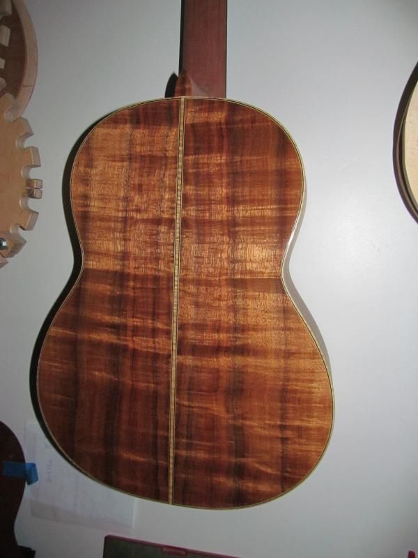

Peter Oberg
Posts: 808
Post by Peter Oberg » Wed Aug 06, 2014 12:44 am

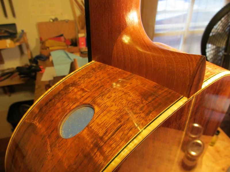

First coats of shellac.

Post by Paul Micheletti » Wed Aug 06, 2014 5:43 pm
Yow! That koa sure pops under the shellac! Beautiful!

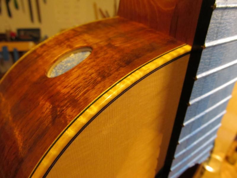

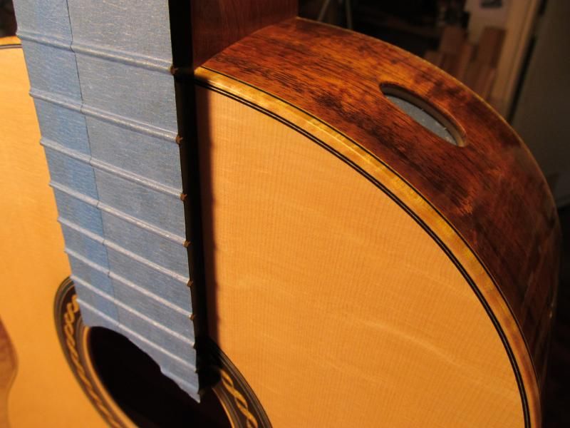

Peter Oberg
Posts: 808

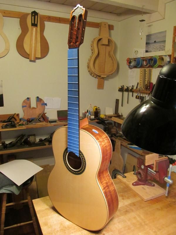

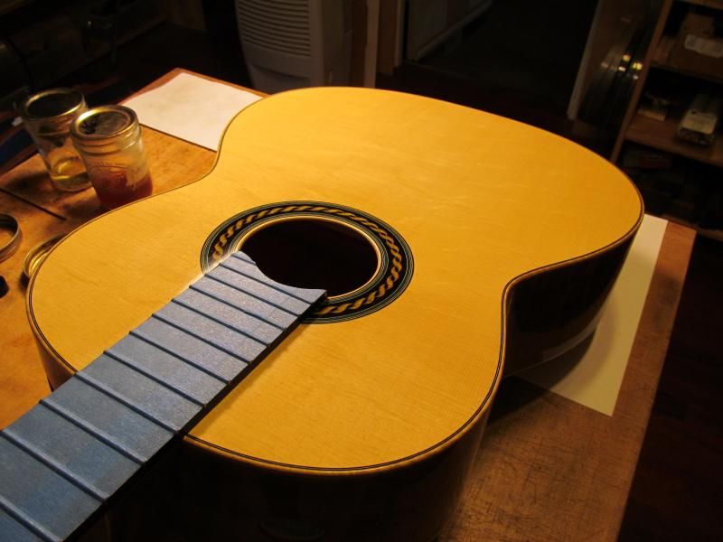

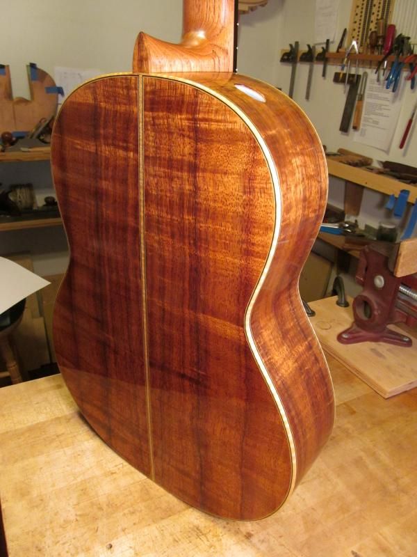

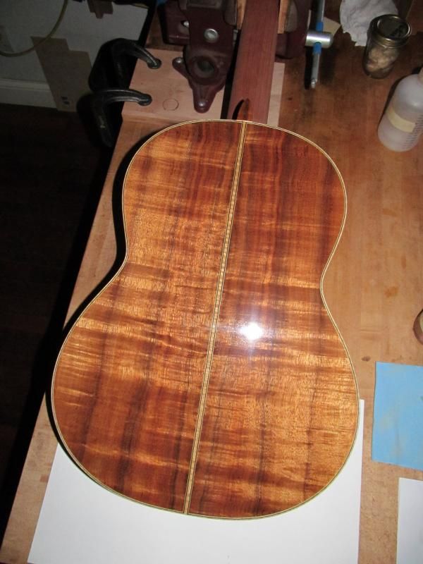

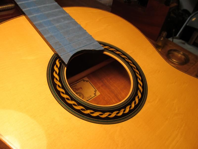

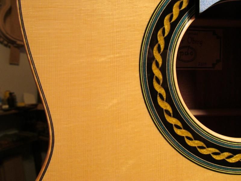

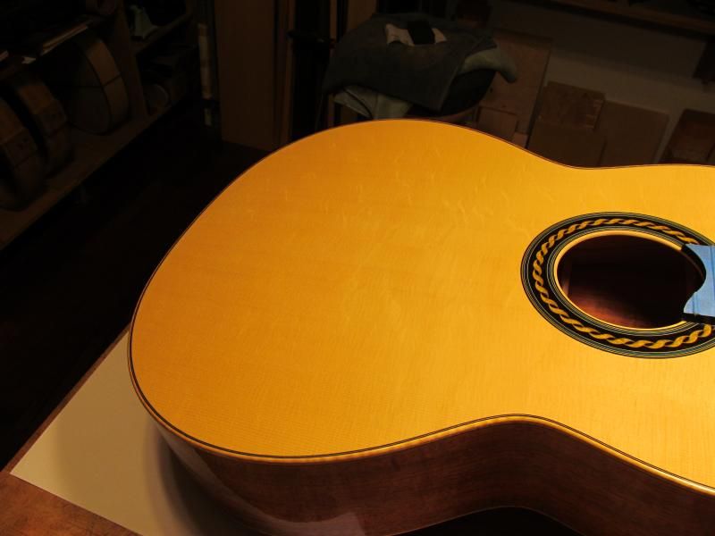

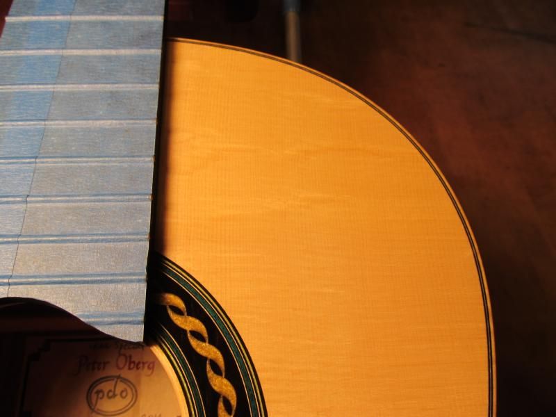

Post by Peter Oberg » Thu Oct 30, 2014 11:15 pm

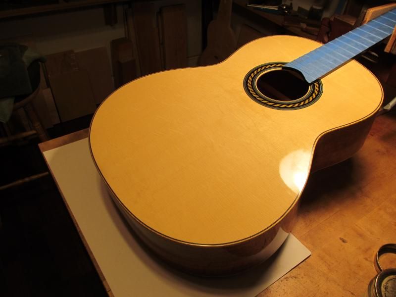

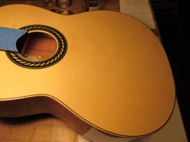

Hello all,
I have been busy with orders, but lately I have had a chance to almost catch up on the polishing of this guitar. I'm in the final stage, and will start the bridge soon, which I plan to photo document and post here. The bear claw on the top seems to be incredibly hard to photograph in my shop for some reason, hence the multiple shots of the top. I really have this thing about while maple, meaning I can't stand the look of it, so I've been trying to get the look of old ivory and I think I'm almost there (the bindings). The shellac is a 'beige'.
