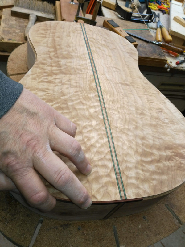

This is my first maple guitar in twenty some builds......it doesn't match what my minds eye is used to, very different working with a light colored material. Every time I look at it it seems new and surprising. It certainly scrapes and works differently than RW, it scratches easier and deeper I note.
I think it sounds more cardboard-ish than any guitar I've ever built. Its very light....feels fragile and light.

I have no relevant comments on maple as a tonewood, but I just want to say that back is gorgeous. The quilting is magnificent. I formally request a follow-up photo once it has finish applied.

One thing to keep in mind is that not all maples are equal. That looks like Bigleaf maple which is usually pretty airy and soft. I really prefer Eastern hard maple or European maple. I think those varieties of maple with their harder, denser properties yield a better sound. Not to say your current build won't sound good, but I believe there's an extra dimension with the harder maples. Anyhow, it may be interesting for you to try hard maple next time and compare it to the one you're building now.
The quilt will look beautiful once finished. Looks like a nice back and sides. I like the green purfling too. :bravo:
You got that right, airy like whip cream ...I got it held in my vice to keep it from floating away.
I get a non-inspiring tap-tone out of it. Sort of rubbery in fact....
I put a cedar top on it and braced it as lively as I could.
We'll see... but I am seriously wondering: what is going to keep this thing from folding up like a jackknife at concert pitch? :D

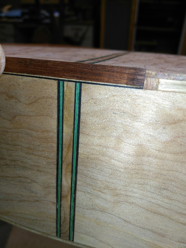

Post by Brian McCombs » Sat Dec 08, 2018 11:08 pm
I'm not moving very quickly at the moment...I do hope it is worth the time.
Grafted, bound and scraped as much as I can scrape in a day.
It is teaching me well a few lessons... I'm used to much harder stuff that is for sure. It scrapes so fast, I have to be careful -it digs real easy. A fingerboard and heel-met is next.
